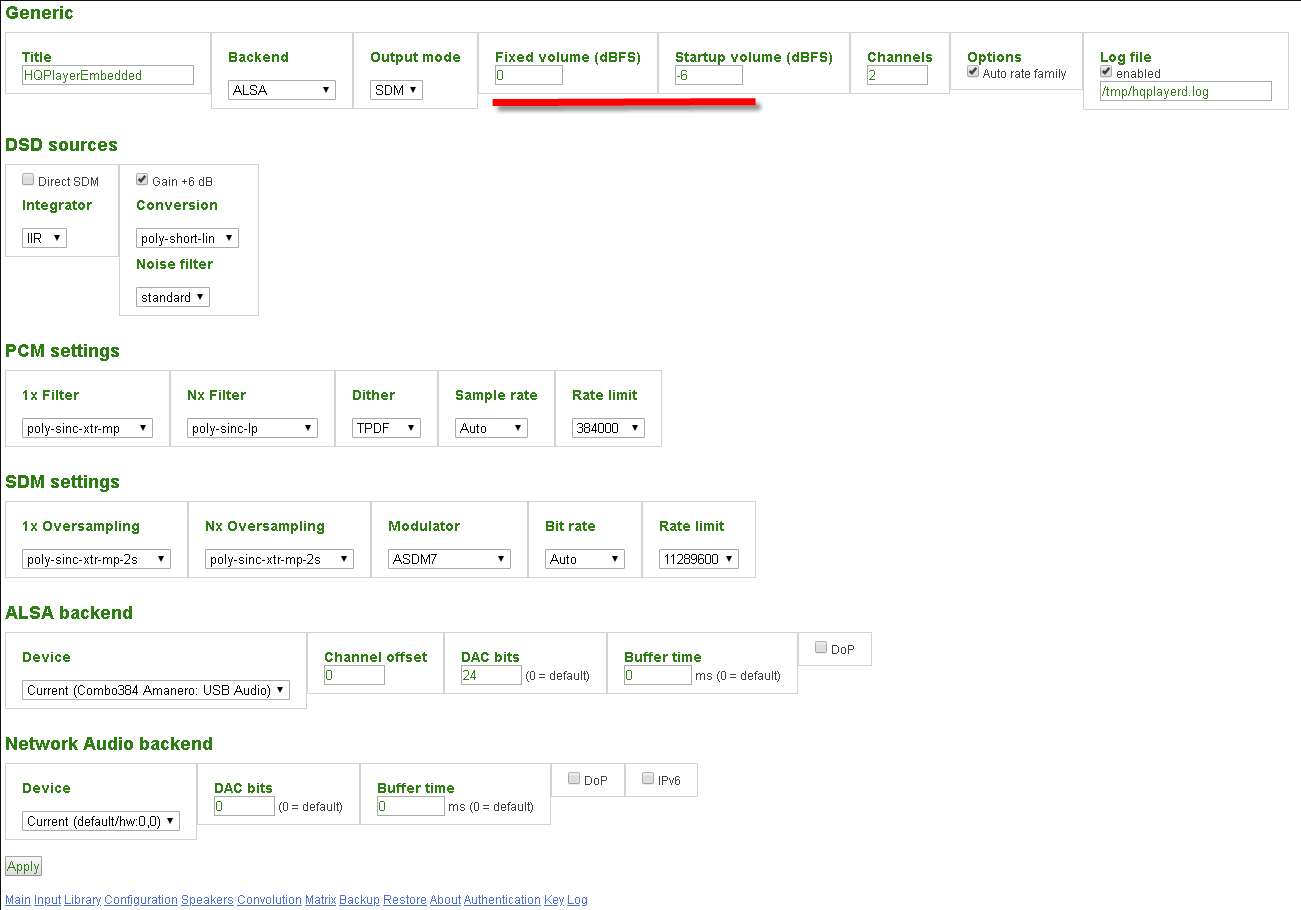

When I’m using NAA option in the Pure, streaming the audio to HQP Embedded, I’m having dramatical drop for the volume of my DAC. Like really huge one, as I have to twist the volume knob on my AMP from 9 to 3 o’clock - to match the output level with the one I’m getting, when I’m using MPD in the Pure. Do you have any idea what may cause it and what might be the solution?
“Pure” does not know how to adjust the volume. HQP has its own volume control and start value. I don’t have the HQPE interface at hand right now. Try to find these settings yourself.
Thanks! That did the trick. In my case, the default volume settings for HQP was -30db! Changing it to recommended by jussi -2, make the music sounds as it should.
