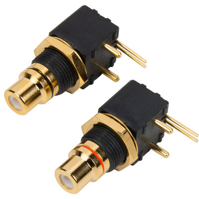

Conn_Coaxial - https://gd3.alicdn.com/imgextra/i1/17455497/O1CN01jiCnxP1qTfujX0P9C_!!17455497.jpg_400x400.jpg
