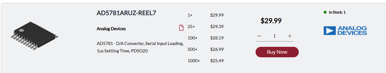

Но стоит реально недёшево, в чипдипе почти 80к. Понятно, что чипдип это ещё те ужи, но всё равно.

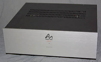

Вот просто для информации, обзор ЦАП за почти 33килодорралов на простом ad1865 без цифровой фильтрации, передискретизации, добавления шума ипр…
Тутъ
И зачем вы мне показываете AD5781, когда сами говорили про AD5791? Вы на стоимость последнего посмотрите (еще и в разных конфигурациях).

While this is not a “state of the art” recording by any stretch of the imagination, and my vinyl records of Billie bring me more musical bliss (or sadness as it were). i’ll cut to the chase here, no the DAC 5 Special did not equal the sound i get from my (almost same priced) analog rig playing the Classic records vinyl version (MG VS-6021). It was close, yes, though the nod most certainly goes to the vinyl. Could be due to slightly different mastering of the two different formats, though they were re-mastered by Classic Records during the same period. While this album is stereo, my feelings are Billie-philes would be better served getting the now out of print (and out of business) Mobile Fidelity vinyl Billie Holiday recording Body and Soul (MSFL 1-247). While monophonic, for me emotionally it is much more satisfying. Yes, the DAC 5 Special is vinyl-like in the way it takes the digital pits and transforms them into analog. Analog is still King in my book for high software availability consumer replay. But then we have DACs like this…
---------------cut here--------------
Оценка проводилась исходя из сравнения с аналоговым трактом…
